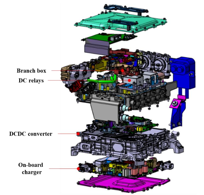

About the ESU on the new eTNGA platform:

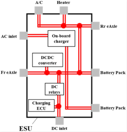

-> Electric diagram:
-> How it looks:

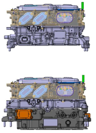

-> Comparasion between the normal 7kW AC charger and the add-on (see component bellow) 11kW charger (TMC is expecting only 20% going for he 11kW):

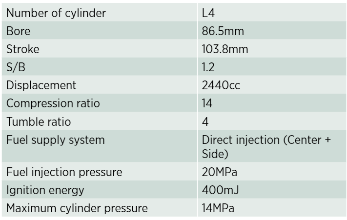

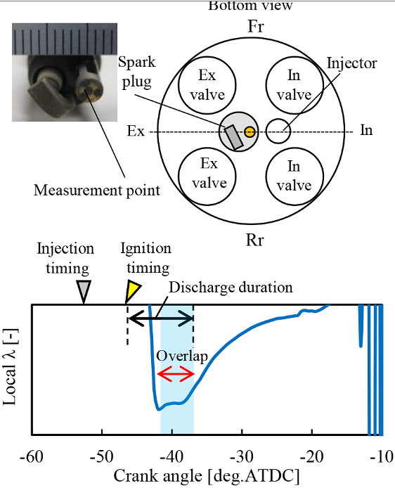

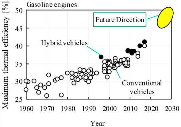

Another new thing, is that TMC is testing a 50% thermal efficiency T24 modified engine!
Disclaimer: It may need to burn H2 to comply with NOx regulations.

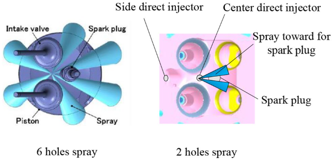

It uses two direct injectors:
And this is where TMC wants to go:
3,896
8,684
Looks like the 2025 46.5% engine is pushed back for a new 50% engine.
Is it turbocharged lean burn or electrically supercharged?
3,896
8,684
So are we talking a revised T24, or is this a whole new engine?
It will change so much it might as well be a new engine.
As far as I know, there isn't any turbocharger developed for this kinds of lambda values (>2.5).
For this they're using a supercharger driven by a external motor.
Electric supercharger is kind of cheating though. The power consumed by the motor doesn't count as a parasitic loss to the engine compared to say SkyActiv-X which achieves 45% but has losses in the belt-driven supercharger.
I wonder why they moved from the previous 1.5 S/B (75 x 112.5) 500cc cylinder back to 1.2 S/B 600cc cylinder with this design. Maybe the 500cc design had too small bore (75mm) to package to center injector?

Another thing to note this has no port injection and compression ratio is pretty high for a turbo engine so a supercharger might make sense
It’s pretty tight on the cylinder head:
