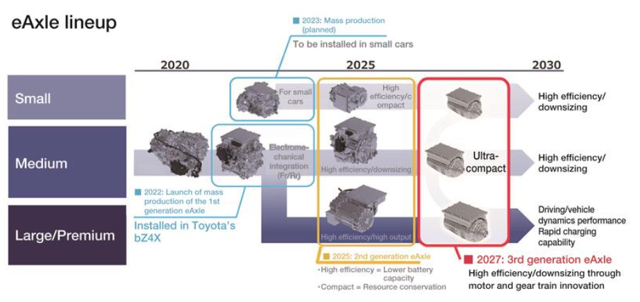

On the motors side, we now know when they're coming:
That Large/Premium system is a 800V arquitecture.
By 2025, we're going to get the 2nd generation eAxle, focusing on improving motor efficiency by 10% and we're going to have 3 versions (Small, Medium, Large/Premium).
2nd gen eAxle:

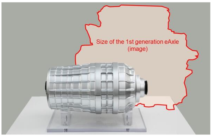

For the 3rd generation eAxle, TMC is focusing on size and weight reduction, looking for 30% less weight and less than half the size:
That 3rd gen eAxle motor prototype was finished in Spring 2022.

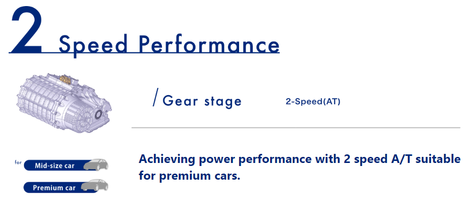

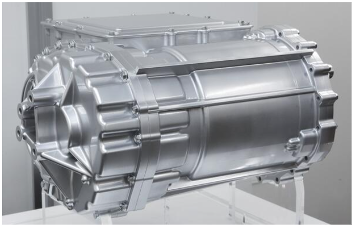

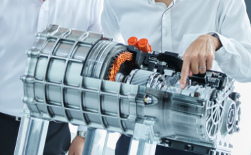

There is also that engine we know it's going to happen in a BEV sports car:
That looks like it has a split box to accomplish the 2 speeds:

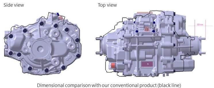

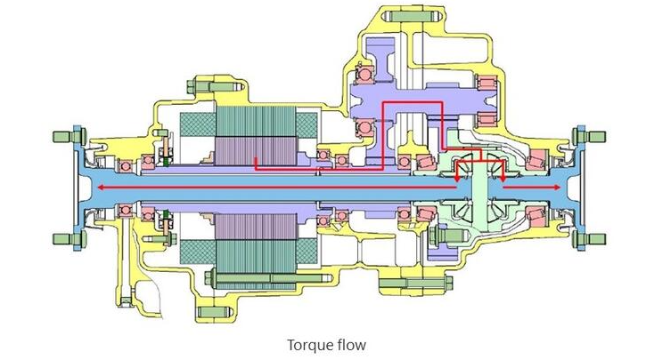

And the new eFour system, that's almost the same size has the previous iAWD systems:
This new system have 5.7xmore power and 1.5xmore torque.

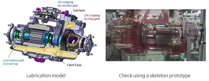

The efficiency was also an important aspect from this motor and TMC even looked deep on how the oil works inside it:

That two-stage system will be in the IS EV not the super car. Also I would like to hear about the 5.7x power and 1.5x torque, what's the source?

So, it went from 5.3kW and 55Nm on the older system to 30kW and 84Nm.
