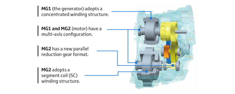

I believe @qtb007 is mentioning the THS system evolution:
  • From ICE+MG's in line:
images
  • To multi-axis MG1+MG2:
But all the new FF-hybrids (Sienna, RAV4 and this new NX) uses the multi-axis setup.
images
Yep, that's what I was referring to. One note: Rav4 hybrid still has the single axis. Prime has the multi-axis.

@qtb007 , RAV4 Hybrid used the P710 transaxle and the Prime uses the P810 transaxle, but they’re both multi-axis.
I don’t recall any new FF TMC hybrid with in line MG’s.
This should be the same combination for the NX:
P710 for the NX350h
P810 for the NX450h+
P710 for the NX350h
Crap, I had the wrong doc up. Yes, the Rav4 Hybrid uses the P710. What I'm seeing for the NX 350h is the P810, though, same as Sienna and Highlander.
