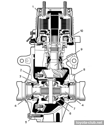

Here are details on the "full-time AWD" system used on NX350. Toyota-club isn't too kind on their comments:
https://toyota-club.net/files/faq/21-09-30_faq_4wd_nx350_en.htm

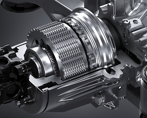

At the presentation of the Lexus NX 2nd generation in June, Toyota announced that the version with A25A-FKS will be equipped with conventional all-wheel drive, while the turbo version with T24A-FTS will receive a "newly-developed, electronically-controlled full-time AWD" which "constantly varies the front/rear driving force distribution from 75:25 to 50:50".
For three months, net communities speculated about this unexpected innovation - after all, Toyota has long abandoned full-time AWD for FF-models. But in September, all the technical details were revealed, and the obscure "full-time" turned out to be a usual marketing trick.
All-wheel drive of NX350 belongs to the well-known DTC (Dynamic Torque Control) type with an electromechanical coupling for rear wheel drive, and its only difference is the manufacturer's promise not to disengage the coupling completely in those modes where the standard DTC already disables the rear drive. To do this, Toyota used a reinforced multiplate clutch with increased resistance to overheating, the number of discs in the friction clutch was increased.
The transfer case for both variants is the same traditional GF1A. Rear differential units differ - usual FD13AE for NX250 and new FD15CE for NX350.
Left: FD13AE/Right: FD15CE
In earlier generations of RAV4/Highlander the DTC AWD system has a 'center-lock' button that keeps the coupling engaged (but still an "on-demand" system). The NX350 basically has the same system but permanently 'locked'. It is NOT a real center diff with locking. You can also think of it as the GR-Four AWD system but without the overspeed on rear axle to create the torque-vectoring effect.
