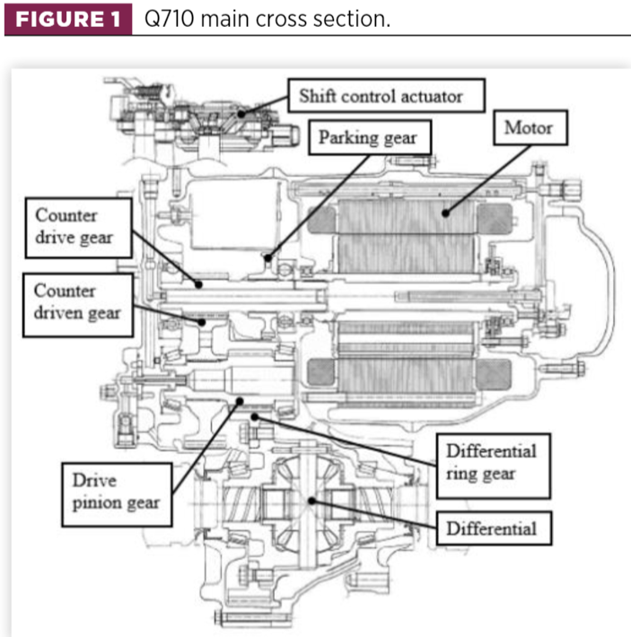

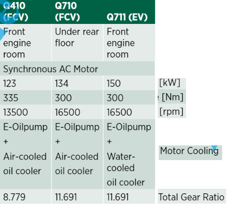

Ever since this Mirai was launched, I questioned myself why Toyota didn't use the same motor from the UX300e... Now I know why, and there're some technical issues to overcome.

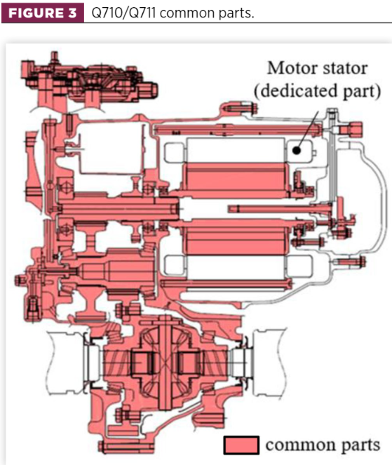

In fact both Mirai motor (Q710) and UX300e (Q711) have been developed side by side, for them to use the same components as possible and to improve performance (low mechanical loss and high quietness) next to the 1st Mirai motor (Q410), but, what’s the problem?
First, the voltage and current is different between EV and FCV so the number of stator coil turns isn’t the same. But even with this, there’re a lot in common:
This (different voltage and current) is also the reason for the power difference between the Mirai and the UX300e:

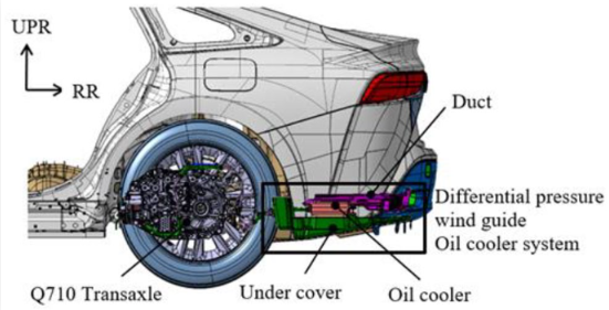

In the UX300e Toyota easily did a water connection up to a front motor radiator, but in the Mirai, being RWD isn’t as easy:

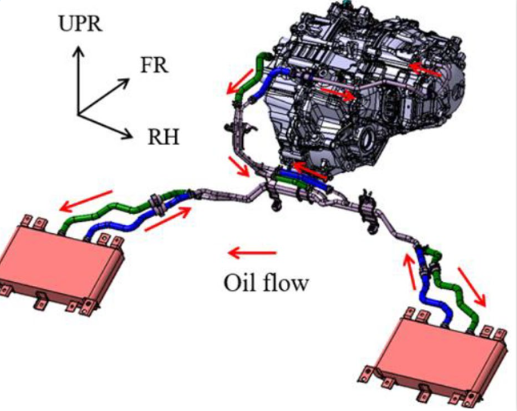

So, Toyota used two air-cooled oil coolers placed in parallel being the transaxle. The motor oil circulates due to a electric oil pump and it cools by pressure differential:
Pretty good in my opinion!
