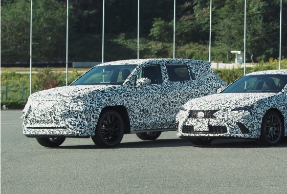

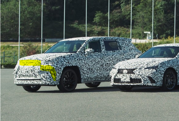

It's just me or this SUV looks awfull a lot like the 2NX BestCar render?
We can see that:
  • Spindle Grill goes really up to the hood;
  • That line where the fog light uses to go;
  • Almost vertical front end
It's just me seeing things or this can really be the 2NX?
Also, this being the 2NX, does Lexus "confirmed" it will have a BEV variant?

They look quite different to me - in the video, the camo'ed prototype has a pretty squared off back half whereas the Best Car render is pretty swoopy. The fenders are also more pronounce and square in the prototype.
But, based on timing, it makes the most sense for that vehicle to be the NX anyway.

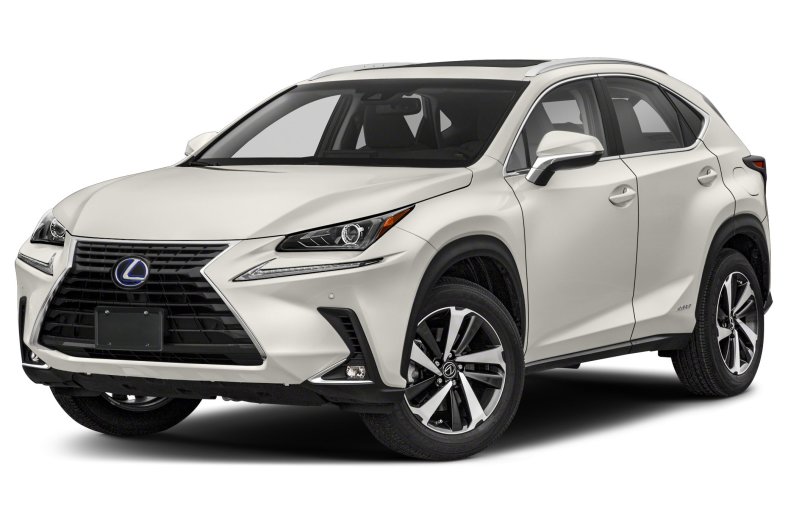

@Gecko, I'm not giving the top part of the back end a lot of attention because they clearly used the current 1NX to make this render:
I'm looking more into overall design language and design features than to the exact proportions of it.
EDIT: At the back, they also made a more squared SUV:
While still using the top part from the 1NX, perhaps to look more production like/easier to do?

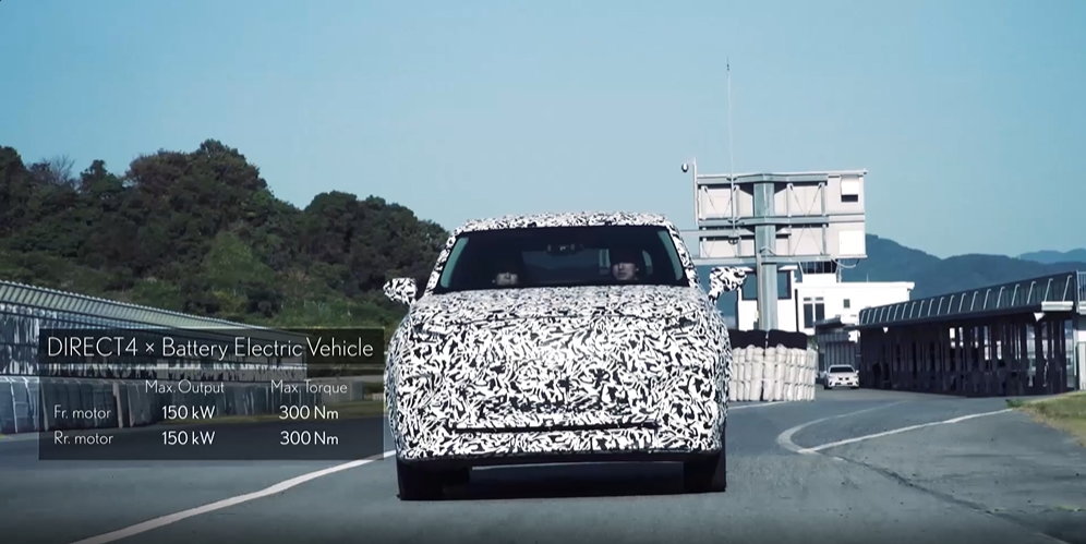

We can see that:
I still think it's the LX. The space from the the top of the front wheel to the hood is too tall for the NX. Also, the wheels are from the LX570. Compared to the ES wheels, they are huge. My guess is LX!

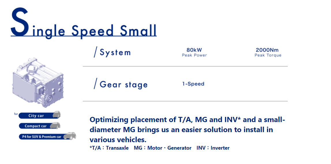

I was looking if I could find any more info for the BZ4X, and I made the following correlation:
This is one of the known eAxle's MG's, and it should be the one present in the BZ4X, and it says "P4 SUV & Premium Car".
Perhaps this is the future RWD MG to go into the eAxle/Direct4 for Lexus?
Perhaps this is what's different for the 500h trademark, a more powerful rear MG?
Maybe to go into the next trademarked RX500h/LM500h and the rumored GA-K hybrid AWD Crown/next-ES?

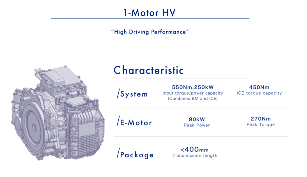

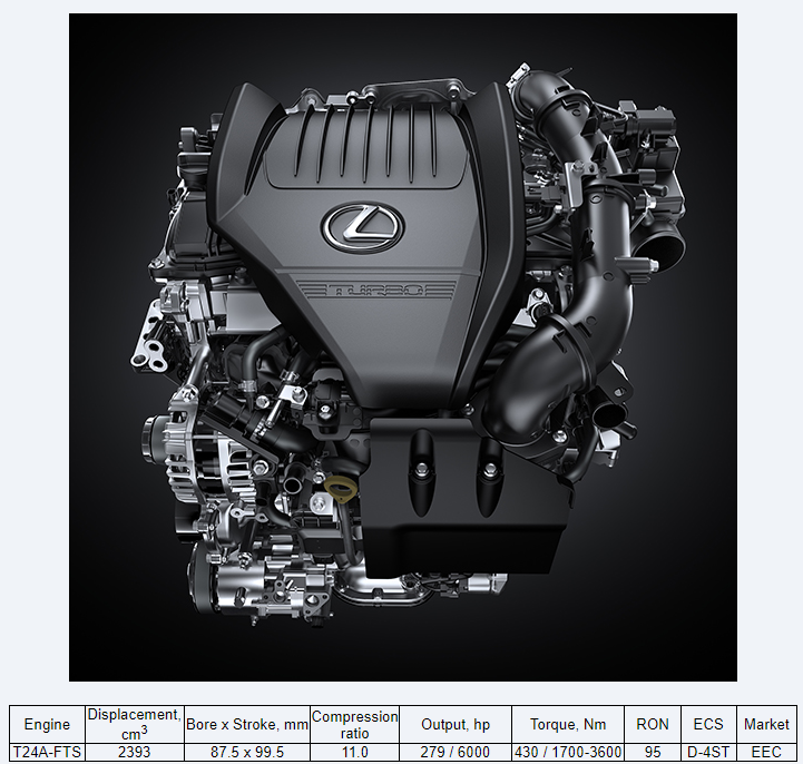

Revisiting this thread about the Direct4/new AWD Lexus hybrid system.
-> T24-FTS
-> 1 Motor HV
-> eAxle with 80kW
This would mean 250kW or around 340hp, that's about 70% of 500 which isn't far from the usual "numerical to hp" conversion for Lexus hybrids and pretty close to the current LC/LS500h.
-> ICE
-> 1 Motor HV (with 450Nm ICE torque capacity, higher than the 430Nm from the T24-FTS)
-> 80kW for the rear wheels e-Axle, it even says P4 for SUV (RX) and Premium Car (ES/CROWN?)
This would be an awesome RX500h and a future ES500h to sort of replace the LS as a sedan...
This system would make a next-gen ES more appealing to even more costumers:
-> Entry level 2.5L dynamic force engine
-> Medium, more fuel efficient 350h 2-motor HV (PSD)
-> More performance oriented AWD 500h 1-motor HV
The EM coupled with the ICE could draw power from the engine and send it to the eAxle to avoid overpowering the front axle.
This also makes (to me) the rumor about the future CROWN-ES relation more plausible since we can have the Crown with a 2.5L I4 and 3.5L hybrid powertrain.
