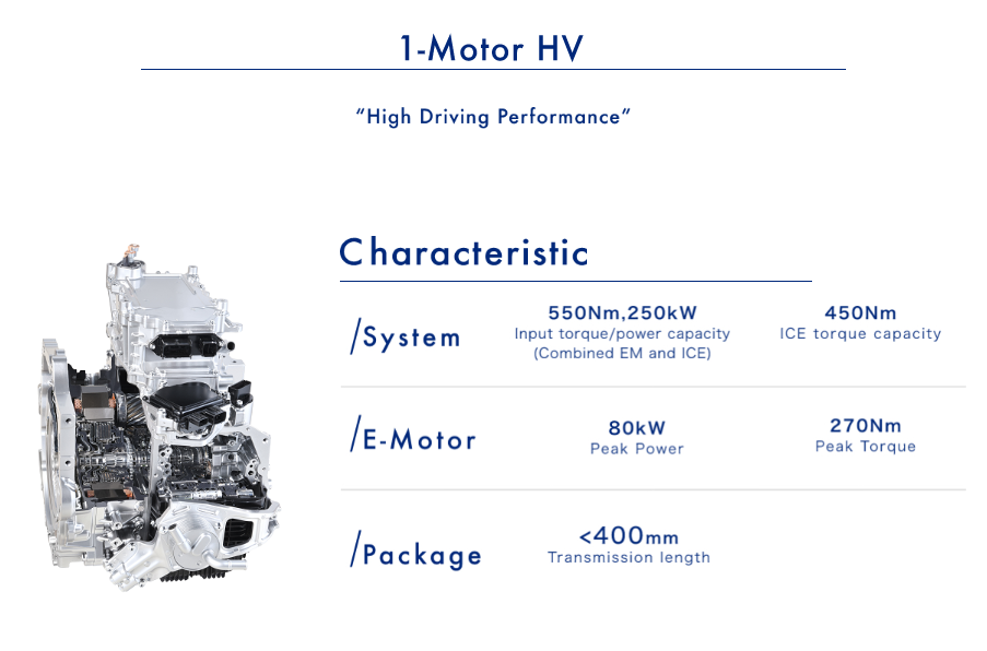

Here it is, the 1-motor HV transmission found in the RX500h (and new Crown):
5,147
I thought I saw something that the RX 500h's battery was slightly more powerful, making up for the 27hp difference?

It was talked about in the Crown thread:
Post in thread 'Next gen Toyota Crown discussion'
https://lexusenthusiast.com/forums/threads/next-gen-toyota-crown-discussion.6477/post-75107
They seem to be using the bipolar NiMH battery that was first shown in the JDM Aqua.
Since this new battery type uses stacked layers, a higher battery pack should mean more layers.
Also, the RX battery have 2 cooling fans while the Crown only has 1… Another indication that Lexus is using more powerful batteries.
