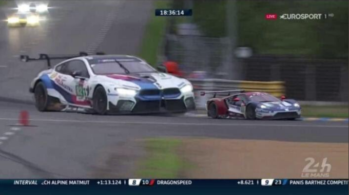

Speaking of how big BMW's look on the track, this is related to the GTE/GTLM M8 but I guess we've all seen a similar meme.
7,537
16,741
The new M4 GT3 is virtually the same dimensions, at least in wheelbase and width, as the M6 it's replacing so we will see how it performs.
Lol I remember those. I do like how the race car looks. I still find the production car so blah and a huge missed opportunity.
