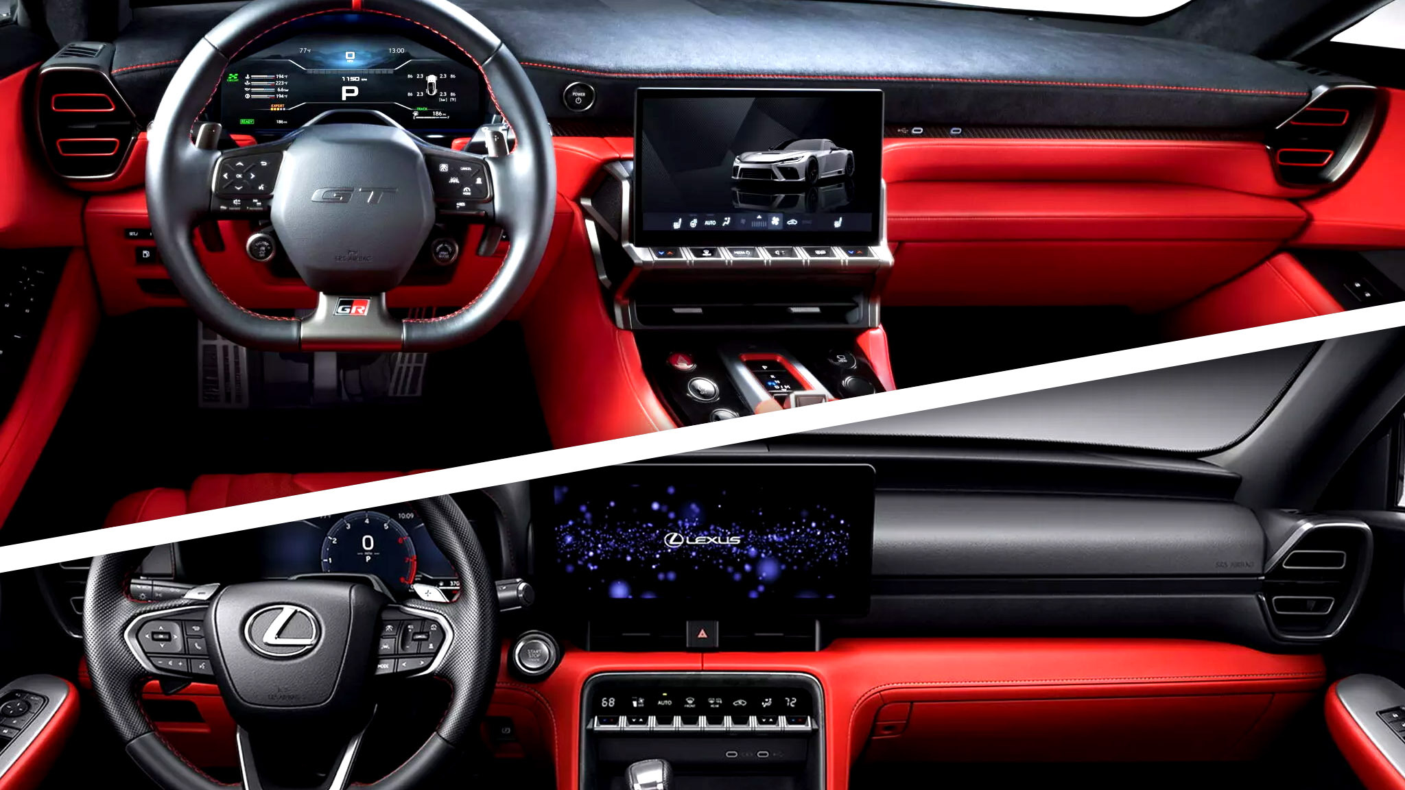

People are starting to pay attention now lol.![]()
Toyota's Most Expensive Supercar Has Something In Common With Lexus' Cheapest Sedan | Carscoops
The new GR GT echoes some interior design details from a nearly 13-year-old Lexus sedan, suggesting a possible link in Toyota’s strategywww.carscoops.com
Controversial but honestly I am kind of glad this was not a Lexus. It does not suit the way a Lexus should look on the exterior or the interior. The LFA design is a LOT better, shame its an EV though.I love how they're intentionally running smokescreen articles to claim it's "parts bin" and not "rebadged", not that that's somehow better but I bet you Akio is sensitive to being too obvious about stealing it.
That's one way to spin "You'll get nothing and be happy."Controversial but honestly I am kind of glad this was not a Lexus. It does not suit the way a Lexus should look on the exterior or the interior. The LFA design is a LOT better, shame its an EV though.
No don't get me wrong im not happy we didn't get this car given the alternative. But, I don't think this looks like how a Lexus should.That's one way to spin "You'll get nothing and be happy."
