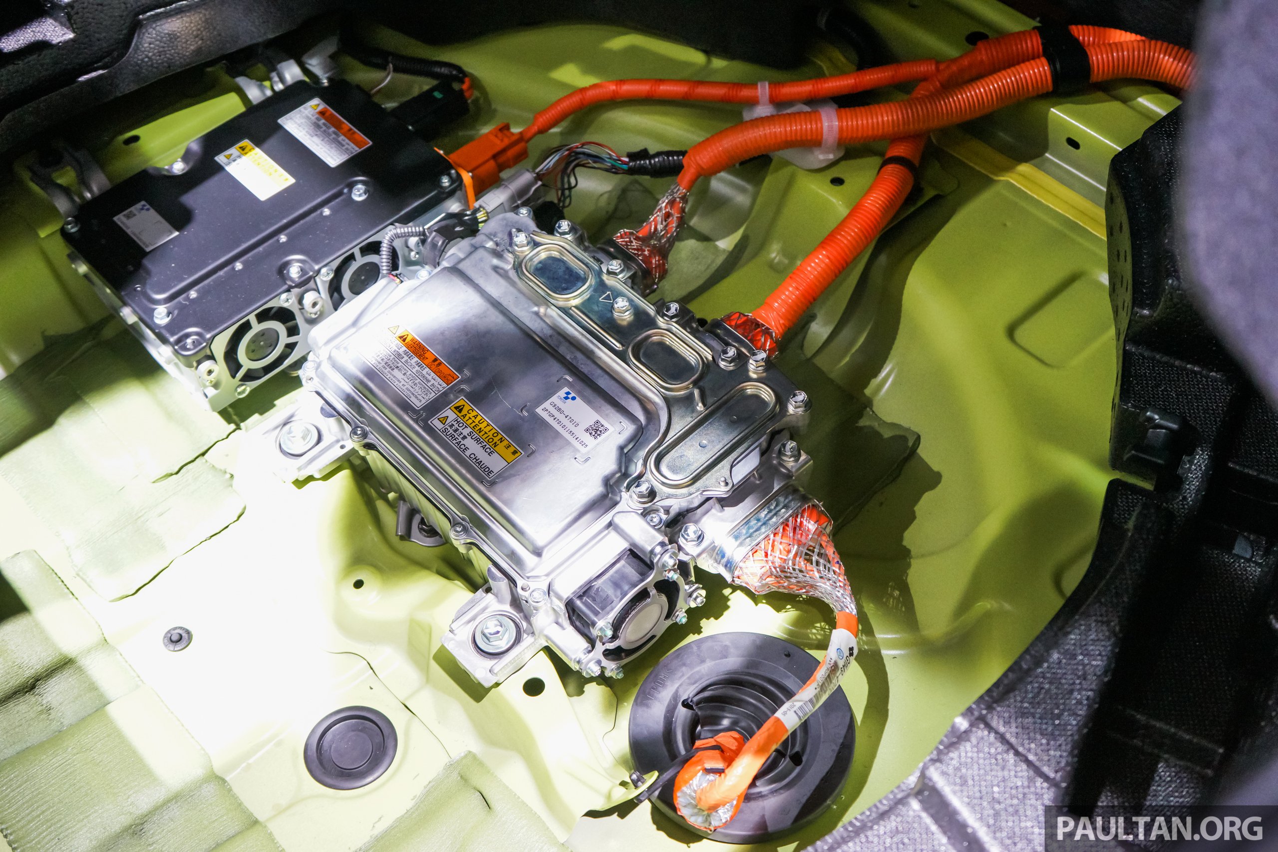

Yes, the new prius is a hatchback and it has E-Four system in Japan and many other markets, so if there is any possibility for the ES to come with an AWD system, I think the ES300h is the only one which may get it not the ES350 or any gasoline model.

This one is a RWD platform, and its AWD is Full-Time AWD, basically RWD
