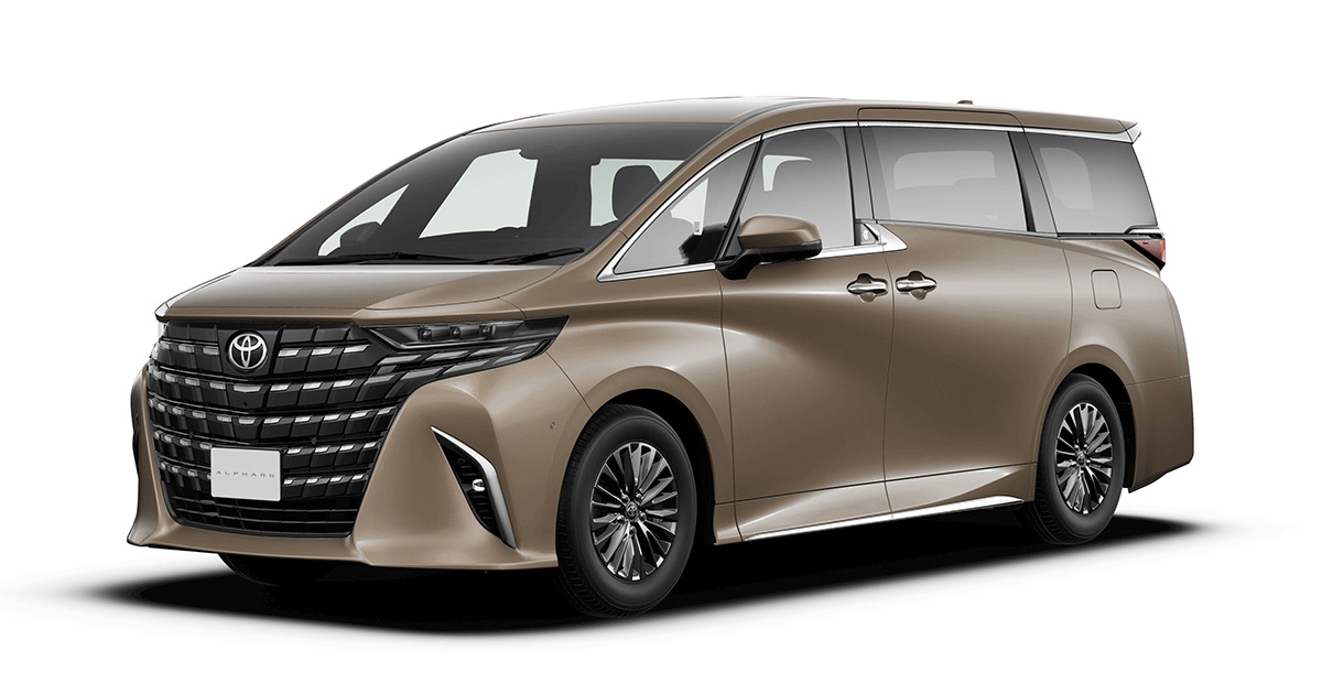

What is the difference between them? Based on video, Vellfire seems sportier and Alphard seems more luxurious?

I love the Hyundai style DRLs integrated into the grille design. Looks really good.
