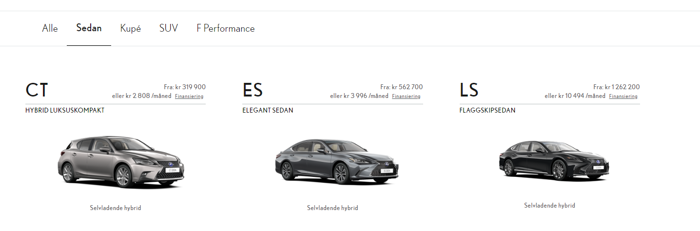

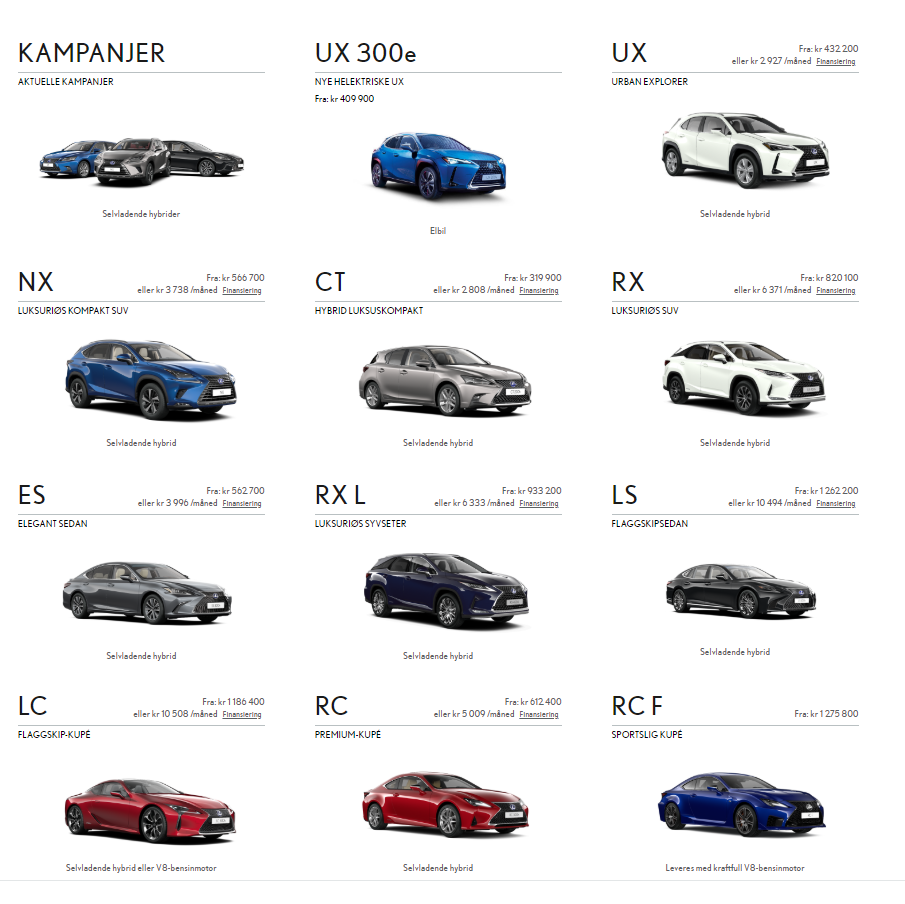

Further confirmation IS isn't getting a replacement for Europe, Lexus Norway only shows this on their lineup:
Curious to see what's going to happen the next couple of months, since I believe current CT won't live past 2020, leaving just ES/LS combo:
