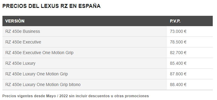

We've pricing for Spain!
To give some perspective:
EQC400 starts from 85.300€
iX3 starts from 74.400€

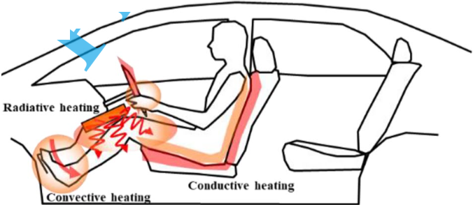

Another thing is the reason for not having a glovebox, it has radiate heating.

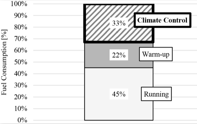

TMC made some tests using a Prius, and running it on LA with low temperatures the normal fuel consumption is as follow:
Because of this, they look into ways the heat the front passengers more efficiently:

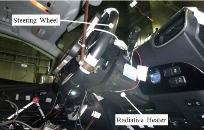

Here is the picture of the prototype Prius:

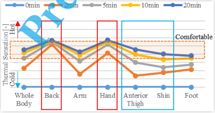

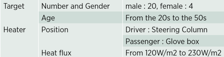

With this, TMC is aiming to heat up the passengers using radiative heat (knees), convective heat (foot area) and conductive heat (back and hands) to use the least energy possible:
All of this because TMC found out that you don't need the same temperature for the entire body:
