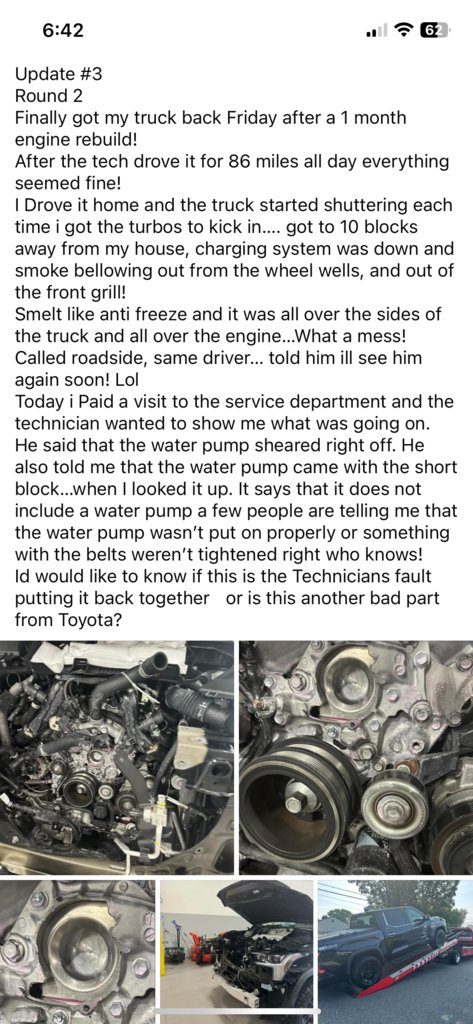

Dear lord. I have a hard time believing this all due to machining debris. I feel like there's something more to this.

who knows wtf is going on....all i know is that this is bringing Toyota's legendary reliability into question.
