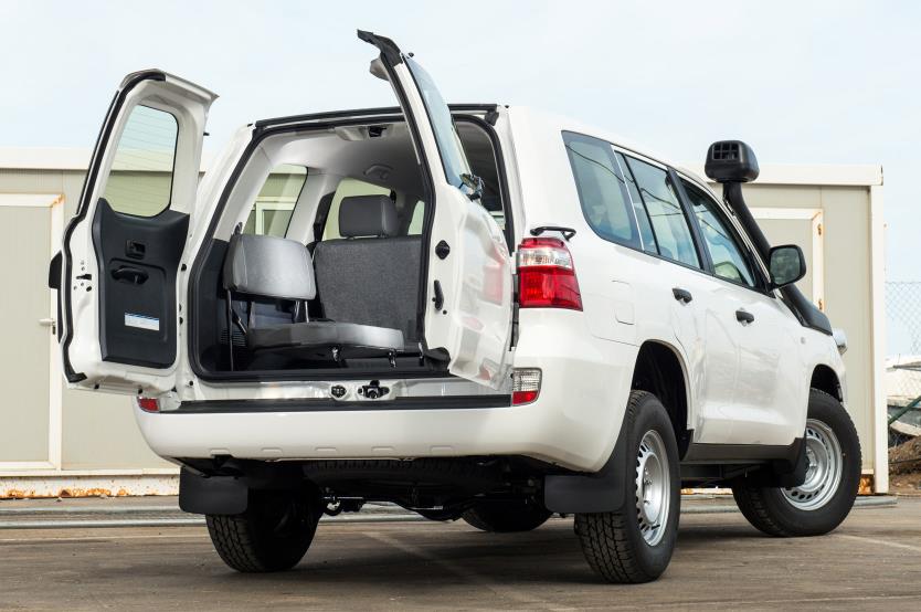

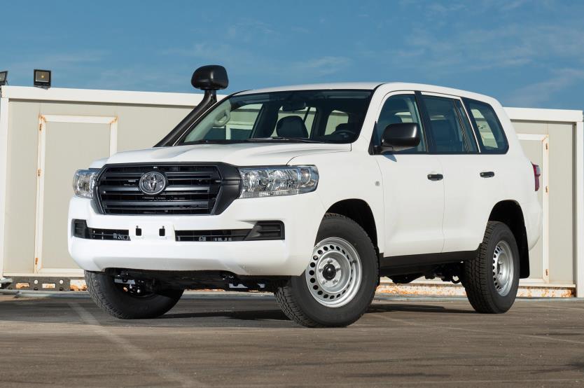

contrary to most, i like what i like about Landcruiser are the basic "NATO" versions.
with the weight reduction, the NA V6 will feel less underpowered than current one. the engine is dead reliable. same 6 auto as old one? this version is first and most a reliable people mover in places with bad roads, not for towing/load or off-roading. also looking forward to new diesel, if it will be adapted for bad fuel quality, if it has adblue and if it can run without adblue.
i understand most in western europe are not interested in it. while i can't afford it, it would be my first choice when I do trips by car to ukraine or romania.
