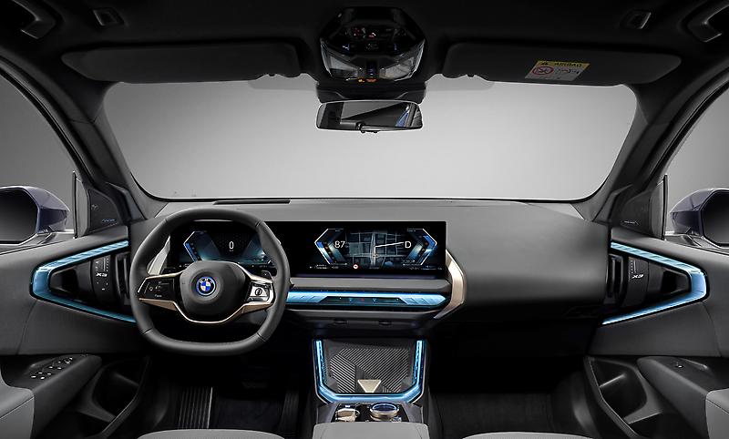

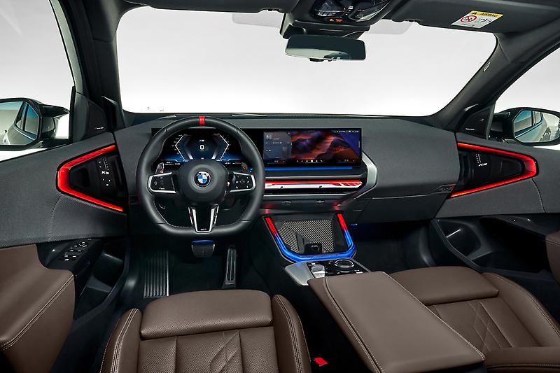

The interior of the x3 is very basement bargain feeling shrouded with lots of distractions like leds lights and screen and really sharp angles. I wish they spent some more money with wood trim or even glass inserts. The exterior is good minus the rear that takes some inspiration from the xm...smh
2,125
I like the exterior A LOT. First good looking new BMW release in a long time.. it's embarassing that BMW now designs better looking crossovers than cars.. the new X1 and X3 look better than the new 1er, 5er, and 7ers.
That being said, the interior is mad disappointing. Looks like major cost cutting took place and it looks like a dark and cheap place to be in.

I'm not too crazy about the exterior but that interior looks... mid-2000's? It also looks like they took interior styling cues from the Toyota bZ4X, which is not a bad looking car on the inside, is just not a car they should be mimicking.
