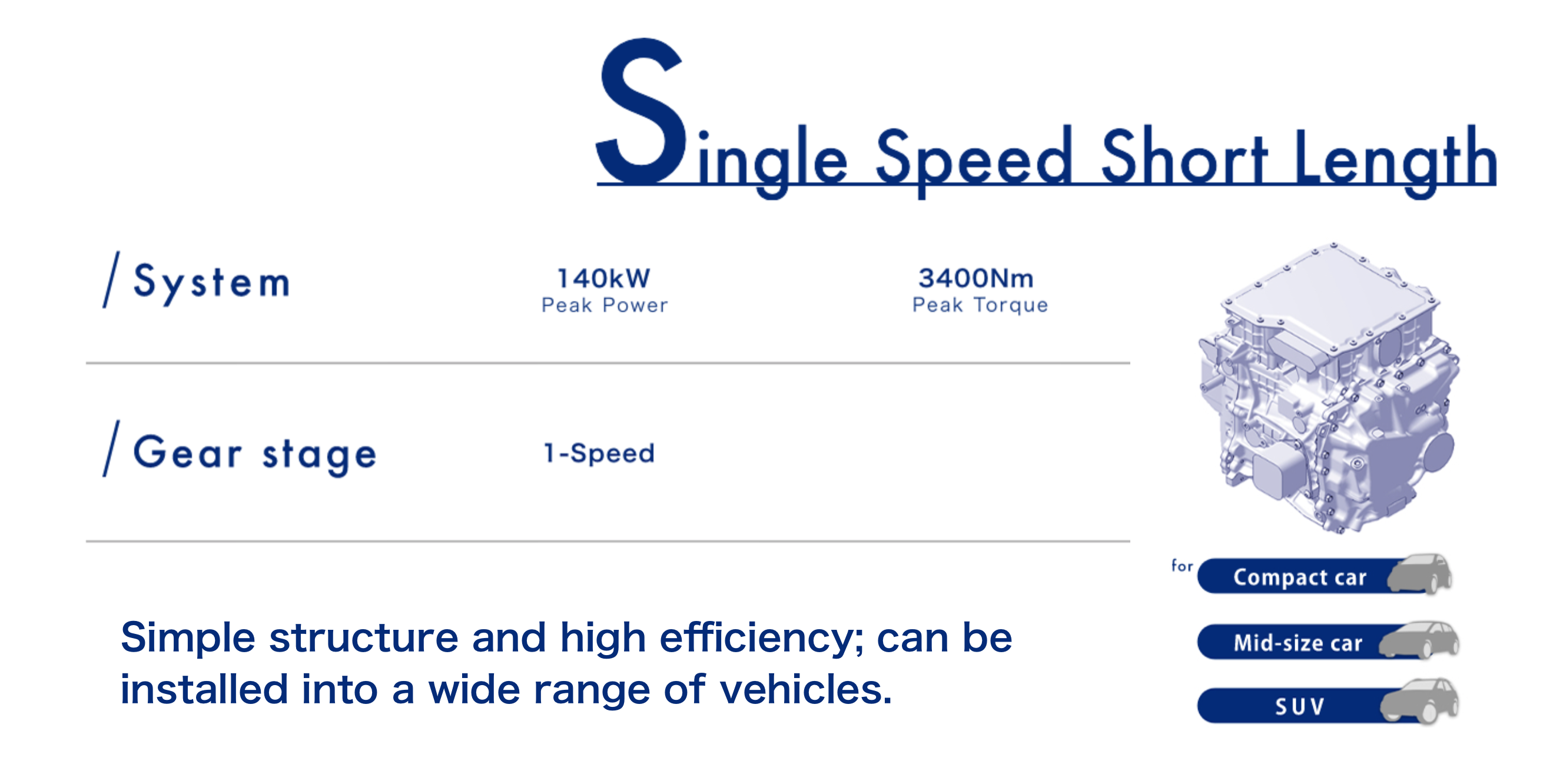

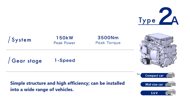

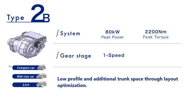

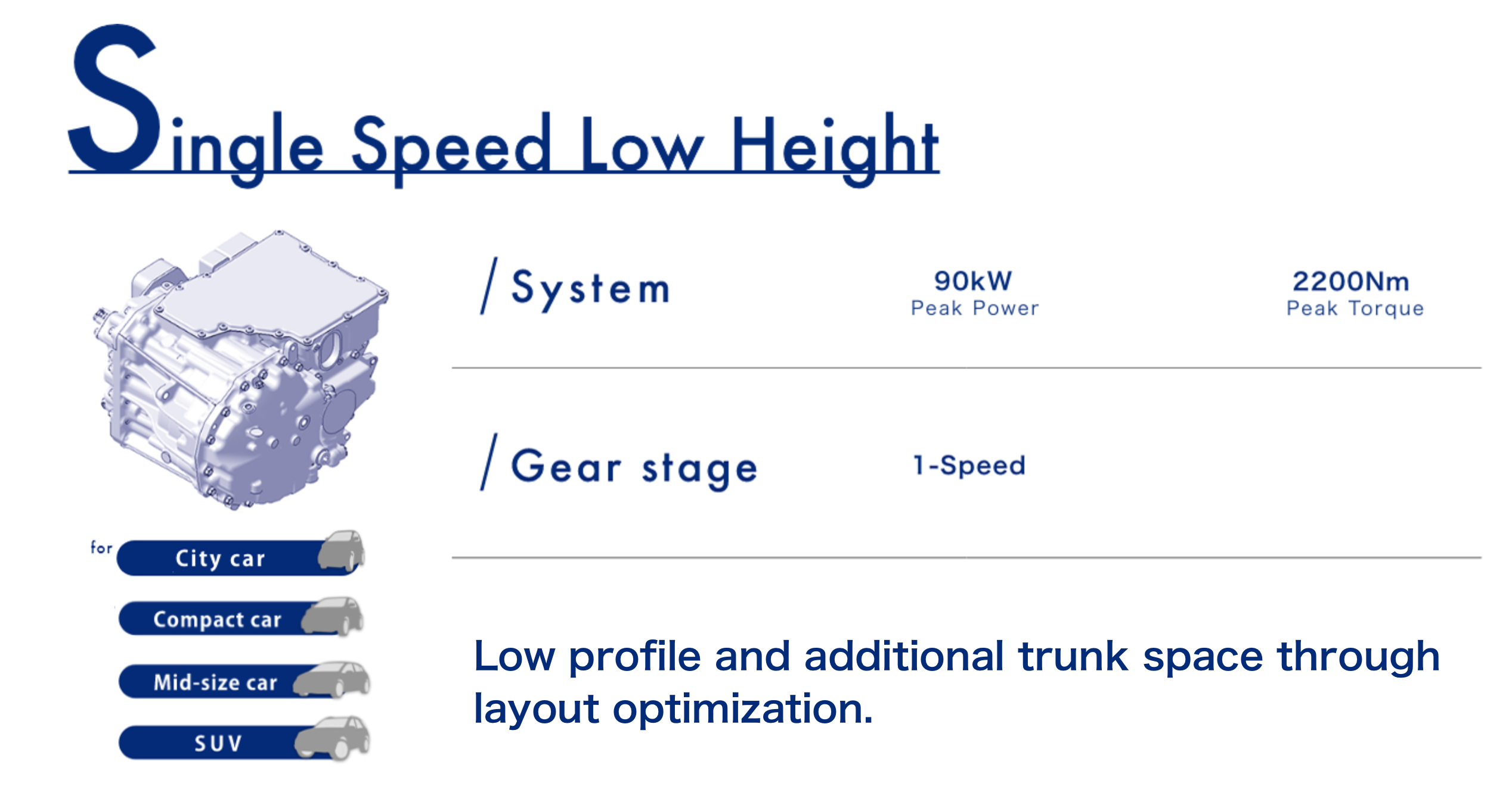

To me, TMC has 2 possible motors for the RZ:
Type 2A / Or updated "Single Speed Short Length":
Type 2B / Or updated "Single Speed Low Height"
Starting at the rear, it can have either one. For the AWD BZ4X the 2B (which is specially designed to be installed at the rear) should be used at the rear, and the Mirai uses a 2A variation.
At the front, it could use the 2A like the FWD BZ4X.
This way, the RZ450e can have 280~300kW (SSSL+SSSL~2A+2A) or 230kW (SSSL+SSLH or 2A+2B).
For reference, the NX450h+ has 225kW, meaning the most probable combination is the second one to give 230kW, a FWB-biased powertrain.
Also, for TMC to keep a similar C rate to the BZ4X, it would result in a battery around 100kWh, which makes some sense to me given it's going to be a RX sized BEV.
Given this, my bet is:
-> 140~150kW front motor
-> 80~90kW rear motor
-> ~100kWh battery
-> 200kW DC charging

^^ 2A = SSSL 2B = SSLH. They are the same exact motor. Actual power output depends on the PCU.
If the 2950mm wheelbase was true then they couldn't fit a 100kWh pack in there. The BZ4X has 2850mm and has an 8-slice pack with 288 cells in 96s3p. Total capacity is 355.2V x 201Ah (67Ah/cell) = 71.4kWh. From released photos they could fit an extra slice with a 100mm wheelbase stretch making it 108s3p with 399.6V x 201Ah = 80.3kWh. That's my guess for RZ's battery capacity. At 230kW it will be slightly below 3C which is still a rather 'safe' value.
